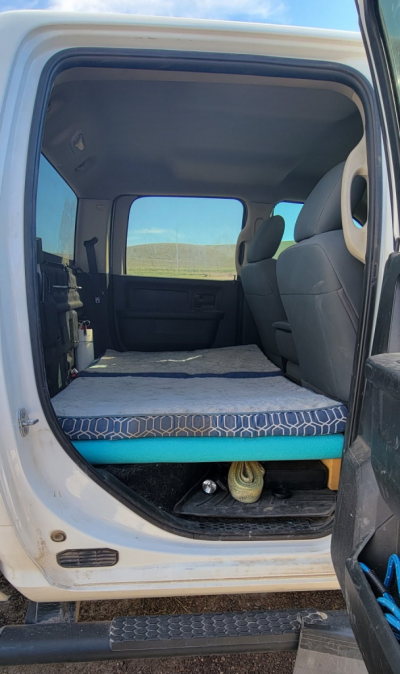

Used an impact gun to get mine, didn't think the Ryobi 1/2" impact wrench would so it, but it did.
Did the cut method, then got tired of replacing the "silencers" every month or so because of the scrubboard roads.
Plus the sheps like the room. (still gotta get a pic of them in the back)
