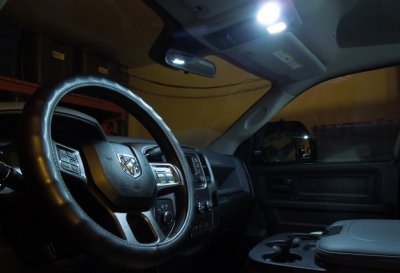

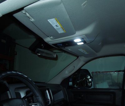

Hi Guys (and possibly Gals),
I was wondering if the 2018 2500 6.4L Hemi 4x4 Tradesman Models are pre-wired for a auto dimming rear-view mirror. I was hoping I could reach in and hook a plug in clip as opposed to tearing apart the roof and console cover thing. I used to have a 1998 Ram 2500 with a slightly bigger auto dimming mirror and miss it quite a bit. The new 2018 has a very small regular ol' manual dimmer flip switch rear-view mirror...
Any ideas or what years would fit? I think it is the twist off mirror type but not sure on the truck currently...

No they are not. You will need the wire harness that plugs into the grey plug behind the passenger side dash end cap. I'm in the process of doing this to my 17 1500 tradesman. The harness part number is 68186009AC w/clearance lights or 68207372AB w/o clearance lights.
