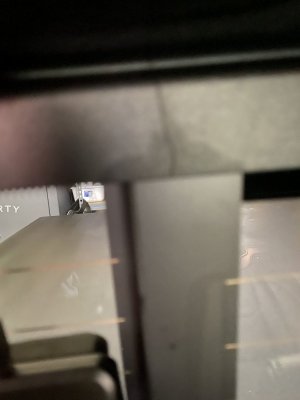

So there I was this morning cleaning the inside if my 2019 Rebel with less than 1500 miles on it, and bam, I see two cracks in my window frame on the top, drivers side where the window lands when it's closed. I guess I'll take it to the dealer today and get the low down. @RamCares

I am very sorry to hear this, @funtruck92. Please be sure to keep us updated on your dealer's findings! If you are in need of any additional support while working with them, I would be more than happy to escalate a case on your behalf.

I went there yesterday and all they did was take pictures to send to Dodge to see if it was covered under warranty. He said that could take 4 to 6 weeks. I would like your help getting this resolved faster. Please IM me.

I just learned of this common issue this week and looked at mine, and yep, add both my 2020 1500 Limited and my son’s 2019 Laramie to the cracked list...... Dealer says they’ve never heard of this before, which I find hard to believe.

2020 Ram Sport 1500 rear window frame cracked in two places. Just bought a month ago and noticed water on the back seats this week. Had dealer inspect and replaced the rear window. The glass company who replaced the glasses showed me the stress on the new window. Expecting new cracks in the weeks to come. Also informed me of the rust on the back of the seats plus a stain on the leather seats. Currently trying to get seats replaced.

We haven't had any problems with our 2019/2020 Rams that I'm aware of but perhaps I'm not looking in the right spot. Is the crack on the inside or outside? Top or bottom of the sliding glass rear window? Thanks in advance to help me (and others) understand where this is occurring.

Inside, top, where 'posts' are on either side of the slider. I believe there are pictures earlier in this thread.
