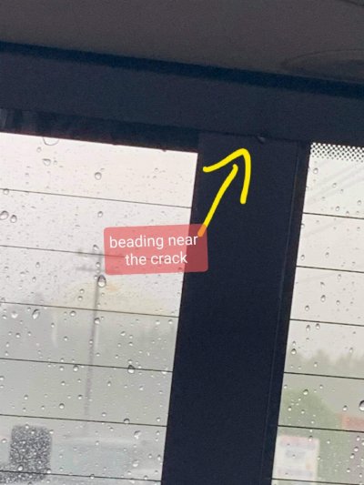

** Noticed my 19 Laramie 1500 DT doing this during a heavy rain today (both sides). Glad I stumbled on this thread and took a closer look...
I'll be stopping by the dealer Tuesday I guess4156819048cfd34ebc24188956fcef8f.jpg

I keep my 2019 parked in the garage, but I parked outside so my son could work on his car. It rained that day and when looked after the rain had stopped, I had a bead of water in the same place as yours. Called the dealer today and have an appointment next week. They said they are going to do a water intrusion check as they have seen it come from the third brake light and the rear window. Of note, my frame is not cracked. The bead of water look exactly like your picture.
