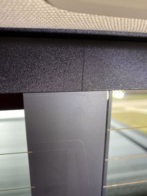

anyone have issues with the rear window frame having cracked. 2019 Ram Laramie 4X4. noticed 2 small irregular shaped cracks on the top framing of the rear window yesterday. I saw a blog on YouTube where the guy talks about this and getting it fixed under warranty. going to the dealer tomorrow (02/21) but was hoping someone would've had this fixed or info on getting it fixed.

Is this what your talking about?

Mine cracked as well. I was more mad I have to re tint the windows. But they had a new part number. Hopefully it fixes the issue. I’m In az and only notice it after the one rain we had. But seems to be ok lol.
