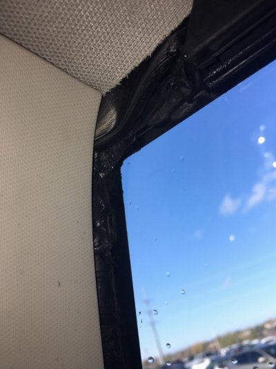

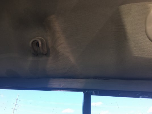

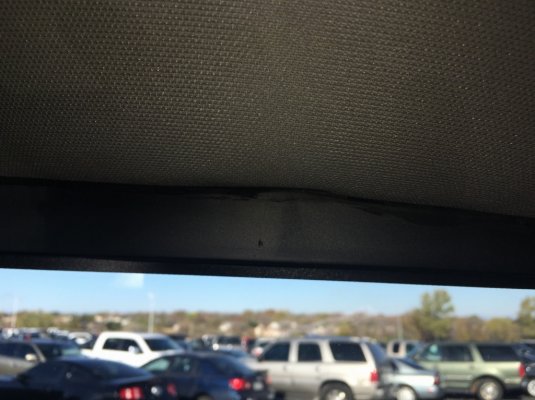

Long story short I have a new-to-me 2013 MegaCab with a third brake light that just won’t seal. I’ve tried a new light; I’ve tried silicone; neither worked.
Last night I cleaned off the silicone and old gasket and installed a new gasket using MD marine/auto rubber weatherseal; seemed like a good, snug fit. Tested it out in the car wash this morning, still leaks.
Bought the truck used with incomplete history on it; I think a rear/side window was broken at one point because I found auto glass in the passenger seat pocket, and I see a bead of silicone along the rear window.
Do trucks come like this from the factory or did some silicone the **** out of the rear window for some reason? Would this cause any issues? I know there are supposed to be drain/seep holes in the cab, but unsure where. Please help!

I would drop the back half the headliner then have someone stand outside with a pitcher of water and slowly poor it over the back so you can find the leak.

Id wonder if its the wimdow leaking and not the light.....like mentioned drop headliner and "see" exactly whats leaking
