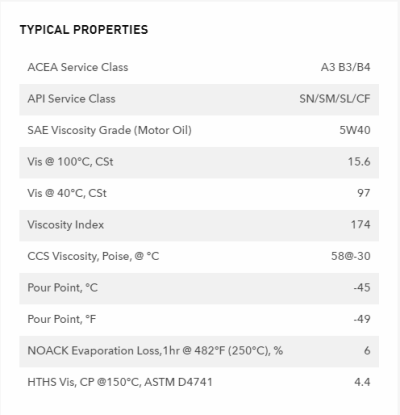

Here are the Red Line 5W-40 properties from their site:

The PUP 0W-40 has a lower viscosity at 100C than both Red Line 0W-40 and 5W-40. I would probably just stick with the Red Line 0W-40 in this case as that is still available. I was looking for something closer to the Red Line 5W-40, which is unavailable.

The Red Line 15W-40 is also less viscous than the 0W-40 at 100C, but I am putting that in my tractor. For the hemi, I will probably just stick with the Red Line 0W-40 until the Red Line 5W-40 becomes available again.
