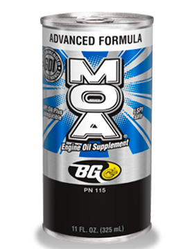

If you wish to extend your interval to save that way, I have done this myself, get the correct filter (rp 20-820) that can handle a long interval, and half way through the interval add a can of BGMoa, which can be used as a cleaner and tbn extender, IE interval extender. As you use oil it denatures the tbn such as calcium, but it still reads in uoa. So you get both a tbn number and a calcium number. The CA number is generally the same as it was when new, but it is denatured so you see the tbn drop. That is why I prefer to add bgmoa half way in the interval, so acid doesnt denature it in use. When you think what benefits hemi cams, it is a legit strategy imo. What is better for the cam, having a stout oil with additives meant to protect cams, or a cleaner oil w/o additives that protect that cam? You can make an argument either way, but I post it is an option. The new bgmoa has more potential then ever as they use MAG over CA. Get the advanced formula if you want this benefit.
