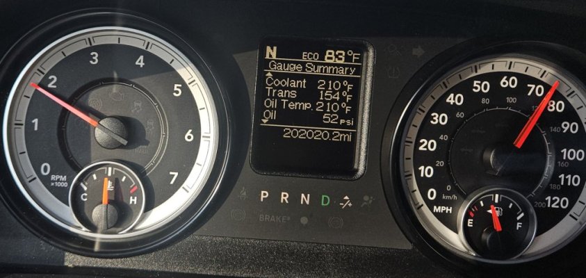

Had to do a bit of running, so I'm gonna be a bit over 202k when I switch to the RedLine. Hope its ok, gonna be closer to 1k on this SuperTech 5W-30 conventional, oil looks clean right now.
Hit an interesting # today:
