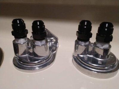

The nipple is part of the oil cooler housing. I’m going to guess the nipple there is not to long but more of a seating issue with the adapter. Either not sitting flat or the o ring. In order to pull the nipple you would have to pull the oil cooler off.
Been several years since I had my adapter off,but I thought it was just a double threaded nipple CK,that just screws into the housing.I might be wrong though,as it's been awhile since I looked,lol. Who's good at looking up parts to see if it shows as a threaded nipple,lol
