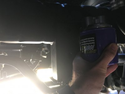

There's a good spot on the frame rail on the passenger side of the truck about a 12"-18" from the OEM filter location, I'll take a picture of it shortly. I'm going to mount it as high as I can so I won't have to worry about damaging it while wheeling it off-road. I'm considering fabbing up some sort of metal or aluminum removable cover that would possibly prevent damage to the remote filter. I don't go off pavement often enough to jump on the cover right this moment, but it will definitely be something I will tackle here in the summer.
GIJoe2010
No sh*t, there I was . . .
Mar 23, 2014
1,931
1,524
Killeen, TX
In the first pic, this is the spot I’m relocating to. It’s about 18” (probably less) from the OEM spot in the engine.
In the second pic, for reference, this is where it will sit on the frame rail next to the drop down bumper support/tow hook attachment point.
As you can see, it will definitely be vulnerable while wheeling. I’m sure I can figure out a simple box type contraption to keep damage to a minimum.
