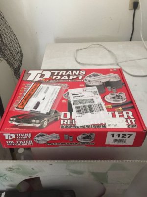

I have had this same kit for months. Just to lazy(busy) to install it. Need to order the NPT fittings and 90* fittings. Makes for a more secure install.
Maybe when I do my winter oil change, when it is much cooler out. Need to look into braided hoses as well.

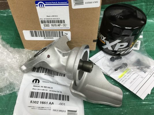

It is a MoPar part, so that is a plus, and it is supposed to fit. The oil filter mounting boss is already drilled and tapped for the 3 screws to mount the adapter. The original filter nipple will have to be unscrewed:
Not exactly a remote oil filter adapter, but accomplishes the same end, easier oil drain and larger filter.

This kit is supposed to fit the 5.7 and the 6.1 Hemi. Here is a screenshot of where I bought it:

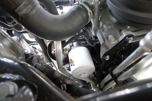

When I was researching this another forum member, or 2, said they didn't think it was for the truck motor. But I think there is no real interference with anything other than on my truck there is a small wire bundle that is clipped onto one of the screw holes and that clip would have to be pulled out. A minor issue. You can see that wire in this photo:
I decided it was worth trying and bought the kit. Will start a new thread with pictures when I get around to installing it.
You might notice a small pressure drop SyN,when I did mine I had a slight drop in pressure.Before the kit mine idled at about 53psi,after relocating the filter it idles at 50 psi.I'd guess it's due to the 90 degree fittings.I upgraded mine to 5/8" hose and twistlock fittings,basically I copied CharonBlk's set-up.
