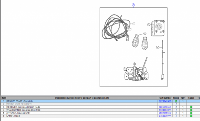

So the kit your looking for is discontinued and there are no dealers in the country that have any inventory according to our locater.
There is a glimmer of hope though as all of the components that make up the kit are still available except for the hood latch wiring. If I am not mistaken I believe someone here on the forum was making them for custom applications.
The image below shows the original kit contents
And here is the install link so you can see how and where the wiring comes into play
Once you review this let me know if you have any questions,

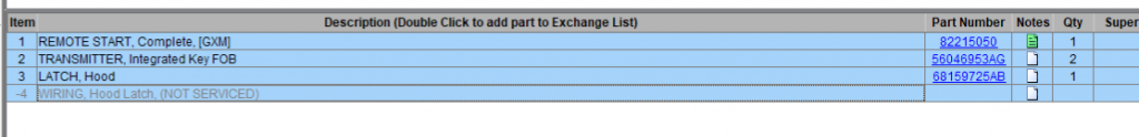

Hey Benny. I need the part numbers for the parts needed to install the remote start on 2019 1500 Classic 5.7.
AllMoparParts.com
- Benny
Supporting Member Supporting Vendor
Apr 9, 2013
2,858
870
All
All
The kit is 82215050 and the individual components are
