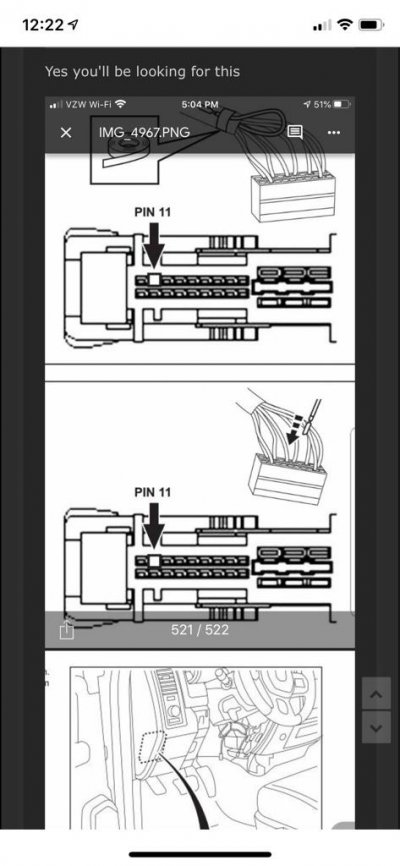

My 14 had the wiring by the hood latch but no pin connection, I think it was pin 11. So it does not mean it is wired. I just bypassed the darn thing and grounded it.
Veritas726
Apr 17, 2017
48
24

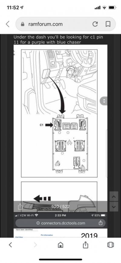

Cut from this forum when I did mine. If there’s no pin 11, sometimes it’s tapped to the wiring harness and ya just pin it in. Look under your driver foot well up and to the far left.
Your RF hub should already support remote start if you have all the other goodies you mentioned already. With that being said all you need is the key with the remote start button and either the hood latch functioning or bypassed. You have to enable remote start using alpha obd. You can program your new key using alphaobd as well.
