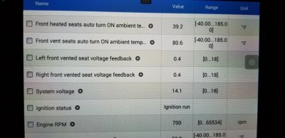

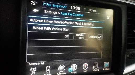

On the 4th gen the heated mirrors and rear window defrost if equipped will turn on automatically of the outside temp is °40 or less. If you have the heated seats and wheel they will turn on automatically if the outside temp is °40 or less if you have the feature turned on. There should be a setting in the radio to turn the auto heated/vented seats and wheel off completely or have them turn on with remote start or all starts if it's °40 or less outside. If you have vented seats they will automatically turn on when it's °80 degrees or higher. Even if your truck doesn't have heated seats the mirror defrost will turn on automatically if it's °40 degrees or lower outside if you have a factory remote start. All of the trucks will automatically go to the previous setting on your climate control in both the ATC systems plus the MTC systems. If you have your ATC system set to (auto) it should defrost the front window automatically if needed but it's operation can sometimes be sporadic depending on the conditions. Another thing to note is in trucks that trucks that are equipped with ATC are on (auto) mode the fan speed will stay very low when it is cold outside until the engine reaches operating temperature and then it will gradually speed up as the truck warms up. This is a pic of the selection for (auto on comfort)702efa7b5a856dd5490504edea27b1d8.jpg
