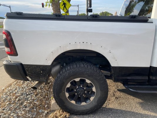

Nope. Definitely has holes in the fender. I wouldnt worry too much about sealing so water dosnt get in there…its gonna anyway.
I agree. Dont like the ‘19 up pw flares. I would stick the ‘18 and back on there!

Heres a pic of the newer power wagons without flares. I think they are just tabs…maybe you could just cut them off and use sticky tape like the 18’ and back have?
