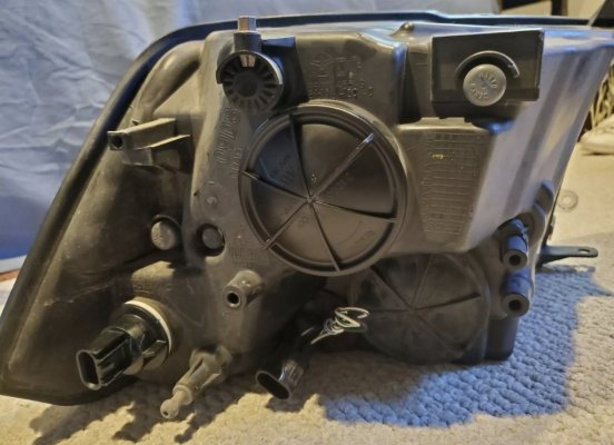

It’s because of the different connector that a factory projector headlight truck uses. The projector headlight uses one 14-way connector- LA1Azf8.jpg
And a quad headlight truck harness uses two 3-way connectors to plug into the lights- mMETTFQ.jpg
Most aftermarket headlights are made to plug into the truck harness of a quad headlight truck. You can still buy whatever headlights you want and make them work, though. You just have to build a small adapter harness. If you need to do this, let me know, and I’ll tell you what parts you would need and how to make it.
