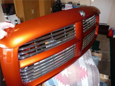

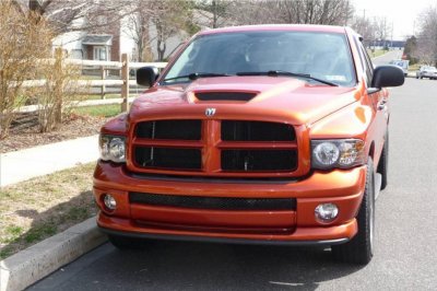

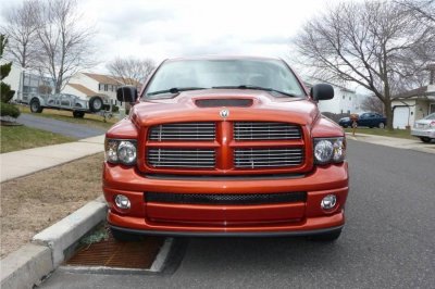

OK so I did the swap today. Butch was right on the money whereas you need to push the pin out. I will start a how-to thread since I took photos during the process. It really was quite simple after removing the grill shell and working on it in the garage on saw horses.
Here's some before and after photos. Don't pay attention to my stock wheels as I run those during the winter and I don't think we are out of the winter storm season as of yet here in Eastern Pa.

Good deal Rob. the black flows much better

looks great!
