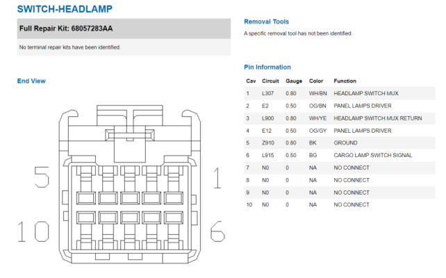

im fixing to add some ditchlights and i would like to replace my OEM headlight switch with one that has the OEM foglight position
would that be all there is to it to grab a hot from there?
i presume i would need to check my wiring harness to see if a hot from the headlights to where the fogs should be is present, anyone know which pin or color wire to look for?
(i would of course use that hot as a signal wire to post 86 on a relay and go from there)

Add the switch, enable the fogs with Alfaobd and add the two fog light pins and wires to the connector under the tipm. No need to use a relay. It’s exactly like adding factory fog lights, your just using the power in another location.

i will say, my stock switch has 6 pins, and the harness has 6 wires
The dash headlight switch doesn't switch power like the vehicles of yesteryear. Nowadays the switches talk on a com truck to the vehicle BCM which controls the headlights/fogs.
You'll need to replace the headlight switch and add the fog light wiring harness to wire in your ditch lights.
If you talk with @Mpgrimm2 he might be able to make a custom harness with longer wiring so it will reach the ditch lights without splices.
If you do use the factory fog light wiring, it will turn off the lights when the vehicle high beams are selected unless you change the programming(disable fog light drop out) with AlfaOBD.

did some research on all this and it is just not worth the hassle, im just gonna slap another toggle switch on the dash, run that to a relay and call it good
