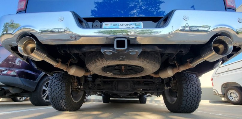

Well it's been almost a year with the 22 inch. And I deleted the resonators. It was worth it! Even though the exhust shop did a really crappy job on the welds...i have pure sound from my maggy and the MDS noise is quiter now without the reso's on which was a suprise! If you have a bigger body muffler i recommend deleting 100%. Im completely satisfied with my setup now.20250604_151229.jpg
