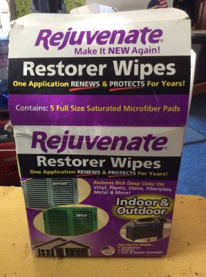

This is what I use, it last about six months, 15$ for 5 pads and usually takes two pads to complete the job.

Yes...works good
It's by far my favorite. I think it last longer than solution finish and easier to apply. Just keep it away from water before it dries.
