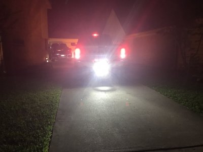

My rear facing lights are doubled wired with a diode, they come on automatically when put in reverse and I also have a switch so I can turn them on whenever I want. I did it this way so I could turn it on for camping or loading trailer etc.

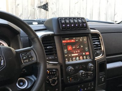

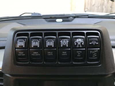

Outta my way are WIG_WAG flashing lights, the Kilroy switch is for my rock lights. The WIG-WAG are my grille lights and amber front lights wired with dioides and dual inputs so they can be solid on separate switches and together on this WIG-WAG
