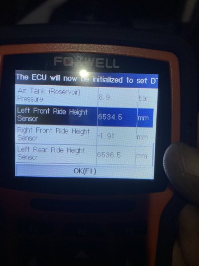

My valve block went bad at 134k miles. While reading up on my issue I took the advice to go ahead and replace the 4 air shocks/springs while replacing the valve block. All went relatively well until I got to the calibration step using AlfaObd.
1) The system will not maintain the 175psi of nitrogen that is specified. The bar-liter reading is around the 280 range. After I do the air mass calculation, the system proceeds to vent to atmosphere.
2) I get a C15DA-00 DTC Payload limit exceeded.
Note: I was not able to run the air mass calculation with AlfaObd (using Obdlink Mx+). It gives me a “procedure failed” error. I ended up buying a Foxwell nt510 elite, which does allow me to run the air mass calculation.
I think my problem has to do with the left front and left rear ride height sensor values. I must have hosed something up because they’re reading 6534mm and 6536mm respectively. This is obviously wrong. Any ideas on how to reset these?
I will try the calibration process with the Foxwell and see if it fixes this. So far I’ve only done the calibration process with Alfaobd.

I ran through the height calibration process and those two sensors are still reading abnormally high values. I'm going to order two new sensors, change them and see if that fixes the issue.

I received the two new sensors. Replaced them and I’m still getting abnormally high values for the Left Front and Left rear.
At this point the only components I haven’t changed are the control module, the front right height sensor and rear right height sensor.Let me not forget the lines.
I am tempted to change the control module. My last resort is to take it to the dealership. They already charged me 2k to replace the compressor, when I told them to change the compressor AND the valve block.

Which software version are you running in the Foxwell NT510 ?
Have you looked at Bi-Directional Testing ?

So I just did the opposite of everyone and added air suspension to my truck. The sensors can read high/low depending on positioning and just general differences in the sensors themselves. So the values they provide are almost irrelevant. They need to calibrated to have the proper offsets applied between what they read and the ride height they represent.
EDIT: I did not see the screenshot, those are crazy high values. Do you have AlfaOBD?
