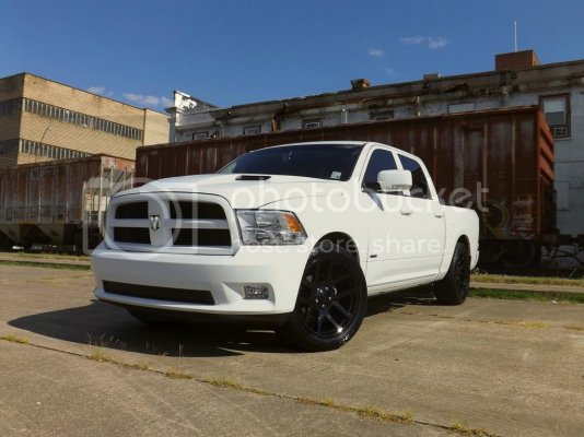

Yea, im running 2'' rear drop on 305/45r22 on the srt10s. Perfect tire size for that stance imo. Check out DUB Push, i have always liked those. If you like the slides, you will probably like them too.

Glad I signed up on here for sure ! Awesome getting help so quick 012rambo got any pics of your truck I can see ? I see you drive a white ram too

012RAMbo
Jan 2, 2014
785
221
West Monroe, La
Thanks man! I actually was torn between the milled and the solid black when i was choosing. I think i chose the solid black because i was worried they might look too busy with all the edges on the wheels. I still think they would look killer though.

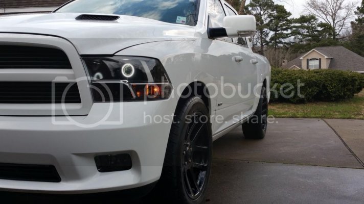

Edit: Rims are 20x10 +23.4 or 24.3mm cant remember
I planned on getting those until I found the rims I have now..
Love the milled look

I like yours too gp, because no other ram has them, not 1! lol Didnt those come off a porshe iirc?
BlownGP
Feb 10, 2013
6,142
1,695
Houston/Baton Rouge
I like yours too gp, because no other ram has them, not 1! lol Didnt those come off a Porsche iirc?
That is true..
Yeah they did come off a Porsche Cayenne
