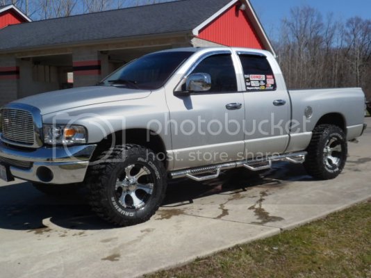

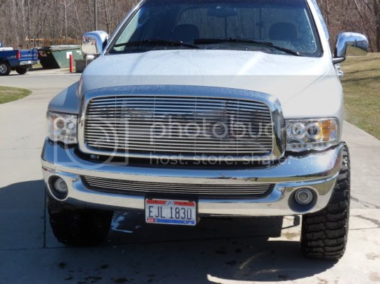

here are mine. 35/12.50/17 10inch wide with a 4.53 backspace. took my stock 20's off. rides better, handles worse. truck just leveled in the front. you will get a slight rub at full turn when you hit even the smallest bump. now that they are half wore, they donnt rub at all.
