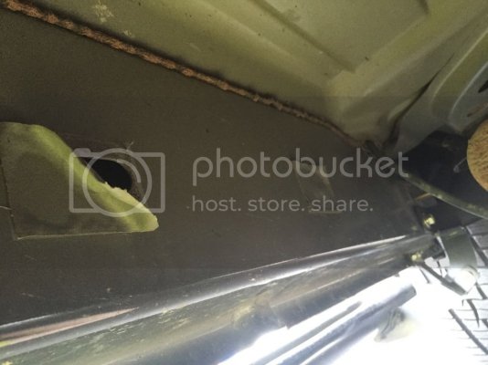

So this is looking at the body as is runs below the doors. That tape appears to have pulled off some and I'm guessing that's where it entered. It just rolls back and fourth. The odds seem so low I wonder if someone is screwing with me.

The tape was peeling off of all the holes on mine I pulled it all off. They need those access holes for the rust prevention spray when I do the underbody anyways.

I looked under there at mine again. So there should be 3 big drain holes on the pinch weld. Unless the rock is to big i would just run a garden hose and flush it right out.
I'm going to assume it's too big because with all the movement it does I would guess it would have fallen out by now. I'll probably try some air in there as well.

If the water can wash it over the hole so you can see it, reach up there with a pair of plyers and crush the FU$&er. Or rip it out.

Bend an "L" shaped piece of metal wide enough to fit in the hole. Wrap Gorilla tape around the 1/2 that fits in the hole, sticky side out. Tape the other half of the "L" to the door bottom. As the rock rolls around, it will hit the tape part and stick.
You can then deal with it.
