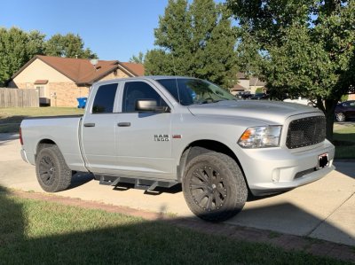

My 2013 Ram Ram 1500 struts have been getting real bad recently and I’m going to ahead and replace them and I’m going to replace the rear shocks as well. Has anyone had any experience with Rough Country’s shocks & struts? My truck has a leveling kit so I was looking at their leveling struts. If not, any other good brands. Their rear shocks also come in either N3 or V2 versions. I don’t need something really high performance like Fox. Just for daily driving. Thanks all.

Thanks everyone. Yes, @RLJ10X, I had a leveling kit to raise the front with the stock struts about 5 years ago but I wouldn’t be surprised if they caused the struts to wear out faster. The strut probably isn’t rated to support a level. I’d like to keep the level I have by getting a raised strut because of my after market rim/tire setup. Plus, I like the look better.

I just ordered the N3 leveling struts and the V2 rear shocks. Mine seem pretty worn down with the noise I’m getting up from when I hit any kind of bump so these should be a big improvement.
