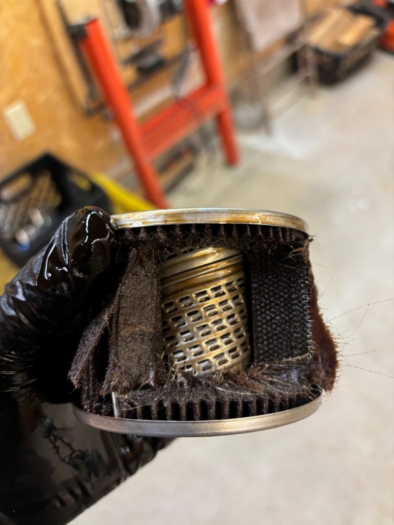

Best going imo is this one puro boss pbl24651 which is the large one like the 20-820. Maybe as good or even better then the 20-820. We have one test where it was middle ground compared to XP bottom and RP/ultra on top, then this test which has it at 1. We know it is 100% synthetic, decent loose thick media with 6 larger holes. I didn't like old puro boss, but this is a redesign and they did a great job on it. The filter is the new 20-820.
Wix XP is no longer synthetic media, so use those at your depression, it does look like a good filter for a blend, better then it was as a syn filter compared to others but wix XP same price less quality.

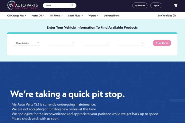

Several of us have ordered here before......no issues & prompt shipping!!!
That site has been down for several months and appears to be kaput. I have been trying to order these from them since October 2025 without any luck.Left many phone messages with no response...too bad
What's your definition of down????

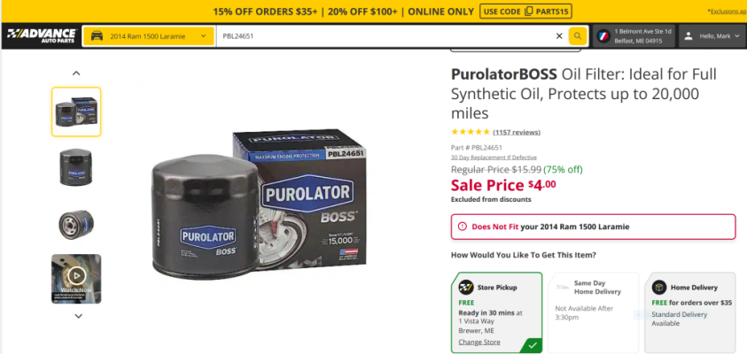

Just ordered 2 of the PBL24651 on clearance locally....thanks for the good discussion guys!!!:birgits_tiredcoffeeView attachment 581609
So the early 4 gens have the larger filter and in later generations such as yours they spec the smaller filter eventhough in 99% of the trucks the larger filter will still fit. It is rather important because the smaller filters in other brands have had issues, but never with the larger filter. Have to read oil filter thread for all the info. If you look down there you can judge for yourself, it isn't that much larger. It will fit the base plate and the threads that is not an issue. Or see above for the smaller filters that will fit, but imo the large in a rather beneficial upgrade in comparison.

That clearance is bad and good news, now it makes me worry if somehow puro is on the way out too. Like dam hell. At 4 bucks I'd buy all I could get and store them inside.
