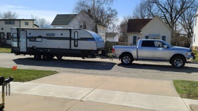

Here's pic with the truck attached and the full tank of water just before we left to go get weighed for reference.
