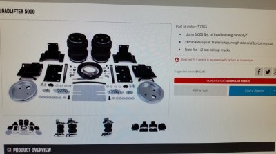

So I'm pretty sure these weren't available when I bought my airlift 1000 bags in the summer. The airlift 1000 bags work well until you get more than 500 lbs tongue weight. I think these would be perfect! Then my truck would always be level with anything I'm towing! (Up to 950 lbs pin weight)
I have an on board air system for my train horn so I think I might have to get these lol.
We'll see if I can talk myself out of it or not lol

Will those work with the ram coils? My dad has them on his f-250 witch are leaf.

Yeah I checked out the install instructions on their site. You remove the bump stop, grind off the bump stop holder, and put this in there with brackets!
It can be used the same as airlift 1000 airbags for inflation so I would be able to just transfer the hoses over to these

Sadly cancelled the order today. Got thinking last night that they might not work because of my lift. The company you had 2" spacers but that added $75 Canadian to the bill, which I didn't want. Plus since these mount to where the bump stop is, 2" wouldn't cut it. I'd need at least 4 to make it work. Oh well! Maybe the next truck lol
