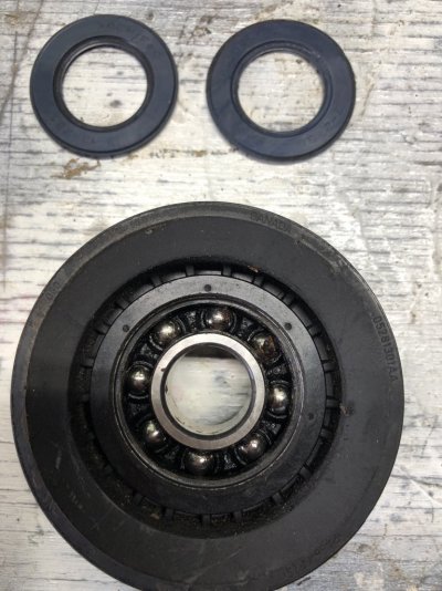

My 2017 3.6 outdoorsman had idler pulley go at 60k. Bearing dry and had play. Replaced with a gates.
Side note, super easy on v6, enough room to stand in front of motor in engine bay if need be!

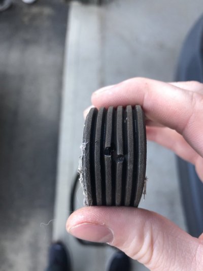

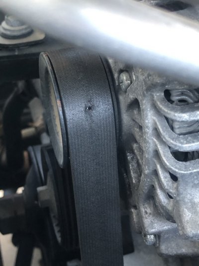

2016 1500 Sport, had around 90,000km/56,000miles when I noticed a hole through the original belt and a few torn ribs. Still not sure exactly what caused the hole. Luckily caught it the day before I moved and was towing a trailer.
