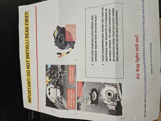

Well i got the part yesterday and openened it today, lucky me the damn thing comes with a piece of paper that says, Important do not install, read first
It doesn't come with the angle sensor. before i ask for a return, is this something easy to replace ? in all the videos i looked i don't see anything remotely close to what those tiny pics show as angle sensor and i looked online and this stupid thing is one of those POS where there is nothing out there showing what it is or how to replace.
54076459546_17a703be1f_o.jpg20241018_141020 by RAM RSM, on Flickr

Are you certain that your truck has a steering angle sensor there? Mine is a 2013, and when I look at the diagrams on MoparPartsGiant, it only shows the clock spring.
And If I remember right, when I replaced my electronic power steering rack/pinion, it had the steering angle sensor built into the steering rack.
Your 2014 should have the EPS as well. So, is it only the 2012 and older with hydraulic power steering, that had a steering angle sensor in the column?
