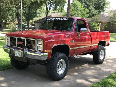

Lol it’s a cool truck, used to be lowered but the Hurricanes convinced me to just level it on 305’s
Here’s the last truck I built and sold before I bought my Ram.
