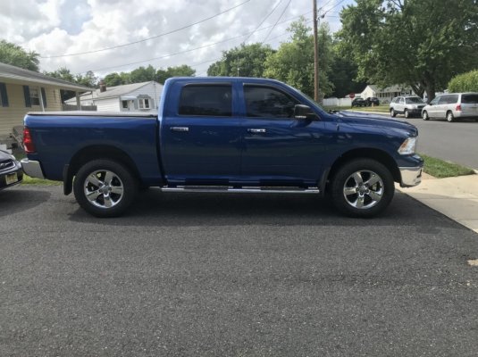

Good choice OP. I love mine at 2.8with the 1.5 spacer. this is with a zone body lift toView attachment 135144 o
love the look and stance you got there. That’s exactly what I was going to do 2.8 in the front and 1.5 spacer in the rear. Was also throwing around the idea of a body lift. What size did you go with?
I did the Zone 1.5" body lift. all of my lifting mods align with the fact I won't park outside, so the truck MUST fit under a 7' garage door opening.
Such a nice truck. I love the look with stock tire size. Never understood raising it 2” and stuffing it with 35’s

2.8
Blue Streak Pearl off-road package

Loving the 2.8, and with the .75” spacer in the rear, kept it with a little rake and looks god and drives and rides great
Mods: EGR matte black bug deflector, Westin HDX drop steps, rough county bull bar with 20” LED, custom made NW seat covers in real tree camo, husky liner mats, husky liner mud guards, undercover LUX tonneau cover, Tailgate assist, flowmaster super 40 with resonators, tinted 15% front, LED C shaped tail lights. Line-X 5.7’ box
depending on the tires, there's only 1.5"-2" or extra tire height total. To me that doesn't stuff anything, but that's me.

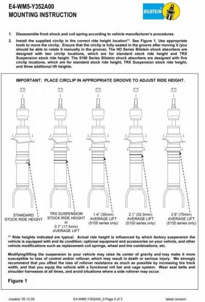

I called the shop earlier today. Told them to order the 4 Bilsteins for my 11 4X4. So I don't have the instructions yet, obviously.
When you guys say for example, setting 2.8, does that denote the amount the fender well will be raised, in inches?

the setting people refer to is the ring placement on the shock itsle. Fender height seems to vary a little from truck to truck

One last dumb question, then I swear that I'll leave you guys alone. I have a 2" puck up front right now (with a blown right OEM shock). Currently, from the floor, to the bottom of my tow hook, is 19". From the top of my front tire, BFG AT TA KOs 275/70/18, which measures 32" tall, to the bottom of the fender well is 6". I'd like to go 3/4" to 1" taller in front. In other words, 20" to the bottom of my tow hook, and 7" in the fender well.
Is there any disadvantage to leaving the puck in, and just going up one notch on the shock? (that should add the desired.7")
Does going up more notches on the Shock do exactly what the puck does, or does going up notches compress the spring more, causing a stiffer ride?
I have an 8" tire/fender gap for the rear. I want the back about an inch higher than the front.

using the shock to go up higher does compress the spring more. from what people report, I'd ditch the puck nd use the shocks to handle the lift.

^ Thats kind of what I'm thinking. I figure the people who make shocks for a living, know more about it than I do.
I'm leaving the rear end alone, going with the 2.1 up front. That should leave about an inch of rake.

I compared a still shot of the 5100 asjustable, and the rear shock/strut on my KTM 990 Super Duke. Now I get it.
The motorcycle shock is up side down in comparison to the truck's, which is what I think threw me. It finally makes sense to me how and why the Bilstein adjustable works.
But it has raised one final question. Since the height adjustment comes from moving the spring on the shock body, why would the spring compress more? It's holding the same amount of weight....
