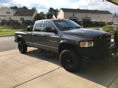

Pics of my truck for the sake of eye candy.
