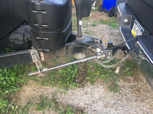

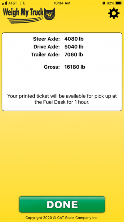

When I towed my step-sons 9300lb TT with my 2500 he had an equalizer WDH and we had the ball set as low as it would go. Weighed out good. My son has an 8100lb TT and has a Husky TS Centerline WDH and we have it set to the lowest setting also. I can't say for sure what the brackets are set at but here is a pic of my sons with the 8100lb TT and the Husky. Here is the CAT tiket from that setup. You might be able to see how far down the brackets are in the pic.

Here is my setup with weights you can compare.
