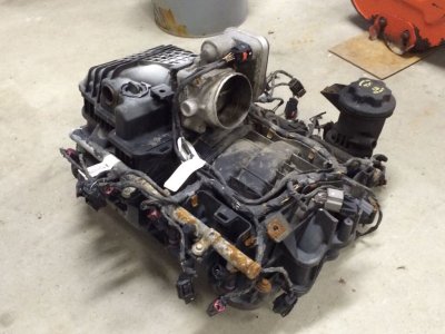

Well I've been wanting to try this for awhile and I finally got my hands on a spare intake the other night. My goal here is to remove and smooth out all the extra and useless plastic on the stock manifold since they look like crap and are a ***** to keep clean with all these holes and pockets in it.
Here's what I started with

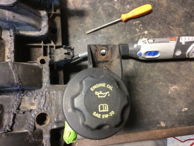

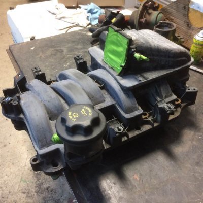

And after spending 5 hours with a Dremel last night here's what It's looking like so far.

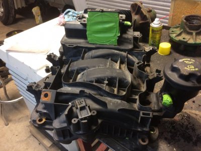

And here's just some of the pile of plastic that has been removed from the intake so far.
Still got a ton of sanding and finishing work to do but I'm happy with how it's going so far.

Nice it looks good. Also I noticed that you like green so much that even your tape is green. Lol

This is a popular mod for the appearance guys on the LX side, should look really good all cleaned up and painted.

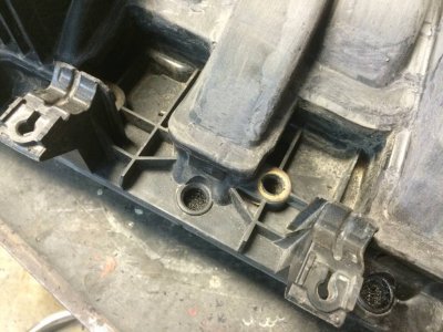

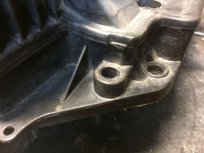

What do you guys think about shaving these little ridges off by the bolt holes? Think I'd be safe doing that?
Still seems like there'd be enough plastic leftover to keep everything solid to me but not sure here.
Most of the holes on the ends don't have any of these ribs from the factory and there would be just as much or more plastic left around the inner holes still when I'm done if I take these ribs out.

I wonder how much of the extra plastic is for strength? It'd suck to get it all pretty and then have it crack under load. Just say'n.
Looks good though.
Looks good though.
I have no doubt ALL of it is there for strength... Why would they waste material over the 100's of thousands of vehicles they produce? I know there are sections required for proper casting, but I'm sure some bean counter engineer did a cost to strength ratio to reduce cost as much as possible.
Now, the question is all that strength actually needed for daily use? Who knows, I'll bet the only way to tell is trial and error either on the individual or spread across many DIY'ers.
I'm sure it makes a difference down to the level of location (elevation, temperature), driving style (bumper to bumper traffic, highway, off-road), and time (miles driven, warm-up cycles, parked in the sun).

I'm not that intelligent about these particular intakes, but I know that the early plastic intakes on Ford 4.6 engines had a habit of cracking in certain places around bolt holes and their fix on the replacements was to add the parts that you're inquiring about taking off. I would leave it personally.

Well After more thought I think I'll leave those little ridges there. I still need reds do everything with finer sand paper then it should be ready for paint.
