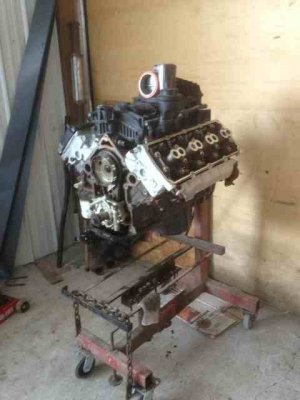

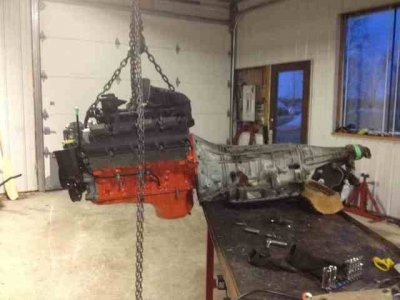

And here's a couple pics of the Hemi when I picked it up.

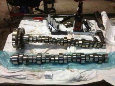

And the Hemi after the 6.1 springs, and pushrods and comp 260 cam was installed. As well as a good cleaning and new paint job.

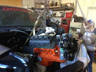

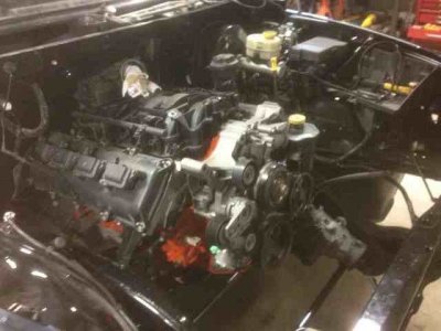

Out with the old 5.9 magnum and in with the 5.7 Hemi for a test fit
I used the stock motor mounts from the 2wd Hemi and they actually fit right into my 98's original frame mount. Now the motor sat way to high so I just used the die grinder to notch the frame mount deeper and level the motor out (sat about an 1" higher on one side)

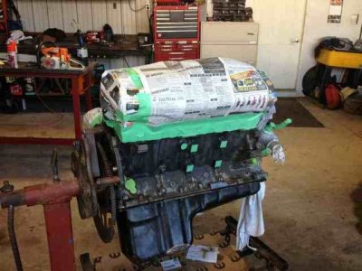

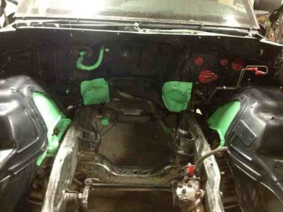

Then I pulled the motor back out and cleaned the hell outta the engine bay!! I cleaned and painted everything in the engine bay before anything went back in.

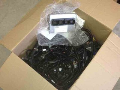

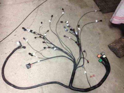

Motor was then reinstalled and I installed the new custom wiring harnesses that were built by Chris at Hotwire auto. He does very good work on the harness and can build them to go into just about anything.

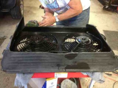

I built a custom mount for my 2 14" flex-a-lite electric fans. I built it to mount inside my old fan shroud so I could keep my stock washer and coolant overflow bottles.
We trimmed the shroud for more clearance from the motor. Since it was super close.

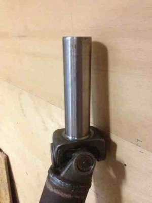

Got my driveshaft fixed up so it will work with the new tranny

Found out my driveshaft is about 2 1/4" to short so it looks like ill be getting a whole new driveshaft after all. :(
