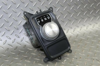

i am getting a 19 warlock and was sitting in a 19 (new body style) limited and noticed the really nice knob. has anyone removed theres yet to see if maybe its the same mounting as the last gen rams? id really love to get one as my new truck comes with the plain jane one. i posted on youtube years ago on how to remove mine on my 14ram and they are really easy to take off

How do the shift knobs come off? Id also like to switch mine to something nicer. I have the factory Express one.
With the shift knob warm "when the truck is closed up in the sun all day" use a small razor blade and pry off the center cap on the knob. Just work your way around on one side "careful not to damage the knob or cap" then carefully pull it off. Its held on with glue, once removed there is a T20 Torx screw to remove then the knob will just pulled off. I upgraded mine from the black tradesman knob to a silver metal one from a sport model. Easy cheap upgrade to do.
