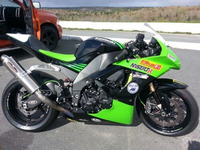

The shorty hp gain was pretty minimal. Long tubes easily double or triple hp but the long tube header prices are stupid. 1k and up for headers is crazy.
Dont look at the cost for motorcycle quality headers then...My nassert beet was $4000 when the 1st come out for my gen 3 zx10...3 yrs later i still ended up payin 1500 for them..
