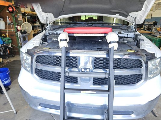

By the way, I get a small step ladder in front of the radiator, put a moving blanket on the engine, and lay belly down on the engine. Take my time and all are easy except for passenger rear plugs which requires moving those wires and heater hoses a little by tugging on them. I have done this 3 times so far and that swivel tool from Amazon is the key. Dodge wanted $900+ just to change the plugs.
