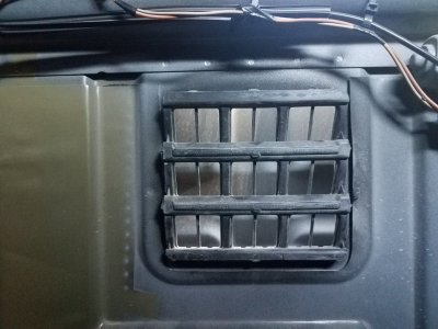

Check your cab vents on the back wall. Both my 2014 2500 and my friends' 2014 1500 had the frame for the vents, but the vents were missing the flaps
