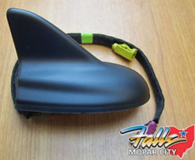

Ok this is what we are working with as far as OEM goes. Notice it has a purple connector towards the logoScreenshot_20180726-131648_Chrome.jpg

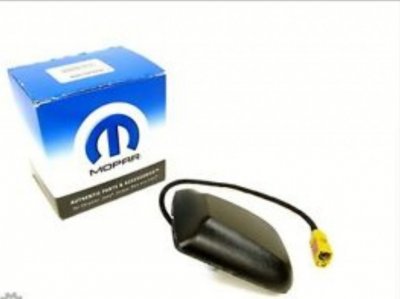

This is what I would like to replace it with but notice only one connection. Screenshot_20180726-131719_Chrome.jpg

The puck only has the SAT/GPS signal on the one connection...

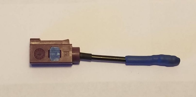

The sharkfin has an extra connector for the cellular modem in the 8.4 radio. If you remove/disconnect it on a 13-17 truck you will get a cell system needs service message on the radio... This can be eliminated by using a cell Bypass Plug (but any uConnect services will no longer function if you sign up for that.

Excellent news! I don't use any of the Uconnect features. Any recommendations on this bypass plug? The plug stops the error message??

If you have a 13-17 truck with the 8.4 radio, then yes. Plugs into the back of the radio instead of the antenna cable.
You can get one from us for $40 ($35 w/anything else).
