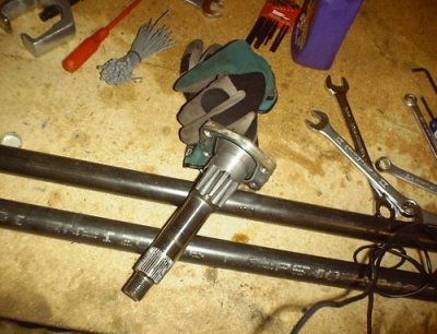

Since we all love pictures...
The Power Piston gear teeth:
attachment.php
The Sector Shaft teeth (notice the tapering) :
attachment.php

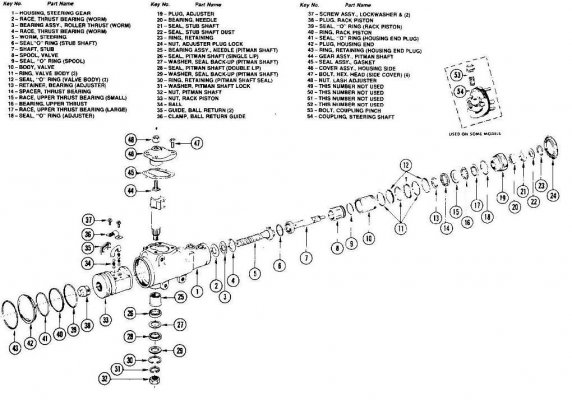

I just got done doing a power steering box on a 1972 Ford pickup... Needless to say its using a Dodge Sagnaw steering box nowand be completely re-gutted...
Now what Rogan saying it very true. The sector adjustment you have to careful with or you'll put more stress on the the output shaft bearings.
That's one of my thing I got to go back and do is re-ajust the box a bit for pre-load on the input bearing ans the sector adjustment.
What I hope you never have to deal with is reloading all 22 BB's back in around the worm gear inside the rack...
