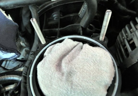

If you decide to remove the throttle body to clean it,disconnect the negative battery cable first,then after it's back together and the batteries reconnected,turn the key to the run position,but don't start the truck,and then push the accelerator pedal all the way to the floor slowly and slowly bring it back up,with-in about a 10 sec time frame,then turn the key back off,open and close the drivers door,and then start it,that should do a throttle relearn/reset.
Be very careful when tightening the throttle body back down,as the screws only thread into plastic and are easily stripped.If you do strip one out,it can be repaired by making a stud out of a piece of 1/4" ready rod/all thread rod.
