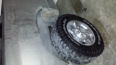

progress update
duratracs mounted and mud flaps removed (finally).
Looks nice.
Phone too dead to take a pic tonight. Will post pics tomorrow.
Slowly but surely...
Rok

Pics

I've heard both sides too. My brother had some duratracs on his 2010 r am 1500. He liked them and then had trouble getting them balanced.
Of course, they were 19s and he just did highway commuting, so I'm sure it was easy to notice.
It was between these and bfg at and I couldn't pass up this deal.
A guy on here who works for an oil company up on the slope says they use them on their company trucks and he was so impressed he bought a set for his truck.
I was sold.
I'll rotate regularly like with any at or mt tire and hope for the best.
