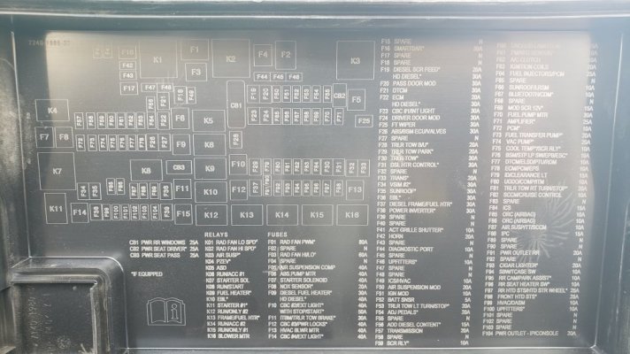

Move the cigar lighter 12v socket fuse f90/f91 over one slot, it will become hot all the time
I wasn't sure what you were talking about but my mechanic knew. The one with the slot is for the rear outlet in my truck so we jumped it.
So, is it the state in the picture, or the other state that has the rear 12V outlet in the "direct battery" mode? Just ordered a panel to wedge behind the rear headrest because I'm having a parasitic drain issue, and I'm f-ing tired of it, but I don't have time to track it down.
