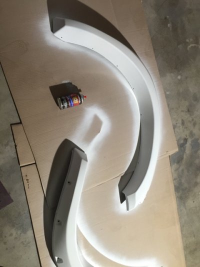

Any auto paint store can mix you up some and can it (expensive).. I used duplicolor from pep boys (inexpensive).. They have most paint codes on the lid.. Worked fine for me but my truck is white.. Maybe try it on a test panel first.
Im using it right now, just don't use their clear coat with white. Has a slight yellow tint to it.
To the grill swappers... Its a pita to take out the inserts. Take your time and be carefull with the tabs... It would be a nightmare to take off the scoops, so we left those on. It will be necessary though to unclip one or two of the scoop clips to access 3 of the insert clips... Recommend a very tiny screwdriver to be on hand.
