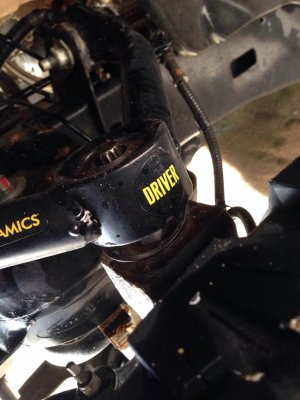

ImageUploadedByTapatalk1395716478.081194.jpgImageUploadedByTapatalk1395716487.598206.jpg
Does anyone know what this is? It looks like a spring coming out of my upper control arm where it meets the spindle

Yep, inset snap ring for the lower portion of the ball joint. Get it reinstalled ASAP.

Got icon on the phone and it is a spiral lock. He said it happens sometimes all I need to do is jack the truck up and push it back in. Thankful it's just that. Nothing is usually that simple with dodges
