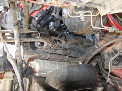

07MegaCabRam
Jun 16, 2014
1,080
578
Chandler, Arizona
6.7L CTD
If I wasn't even in a hurry, I would do mine in under an hour for sure.
I could have the passengerside done in 20 minutes.
The front 2 on the driver side - 5 minutes.. then the last two are a bit harder.
But I also went through the fender well!! haha
Don't worry, the more you do it the faster it will become.
You're a pro at it now!
